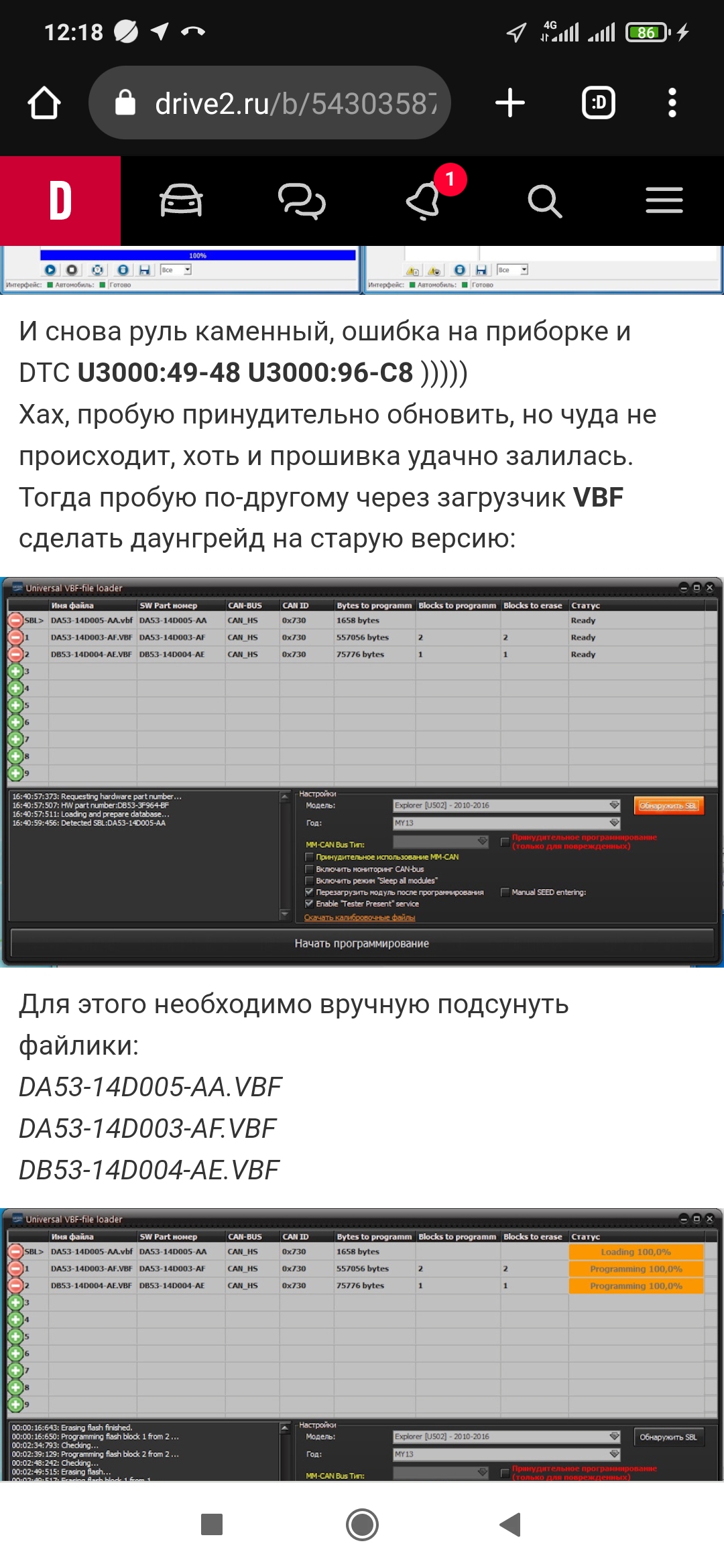

ranjan New member 21 Авг 2023 #6 Нашел пример Screenshot_2023-08-21-12-18-56-653_com.android.chrome.jpg
